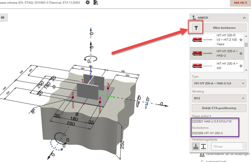

I am designing a connection with anchors HAS-U 8.8. In your cathalogue is written that they are available also in M12 or M10.. why dont I have this option in PROFIS Engineering 3.0.85?
Moreover, can I do calculations with HTS anchors in PROFIS? I cannot find the anchor type.

Thanks for your question. HAS-U is available in M10 and M12, so I'm not really sure how it does not appear for you.
Can you try to select the filter and make sure you really selected the HAS-U (in any quality with any coating) in combination with the HIT-HY 200R or the RE-500v3 and check if it really does not show up?
This should also solve your other question concerning the HST anchors.

Dear Team Tech Service, thanks for your quick reply! I tried to start a new project and you're correct, I could find anchors HAS-U M12 or smaller. I realized that these options went off when I selected the drilling method as Core drilled (with roughening tool) instead of Hammer drilling. I guess that is the issue with M12 or smaller
