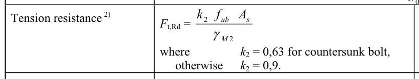

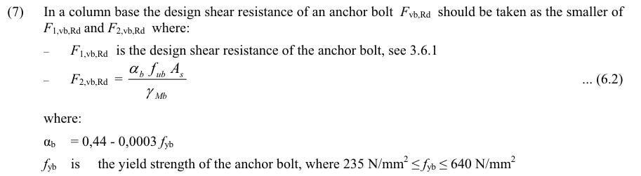

I see PROFIS checks anchor steel failure based on EN1992-4 which is different than EN1993-1-8. The result of tension check is not much different but the result of shear check is quite different.
Is there an option within PROFIS to check the steel failure of anchors according to 1993-1-8? or this is not applicable anymore?
